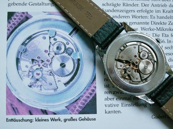

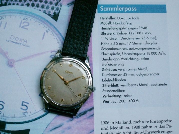

Er zijn verschillende uitvoeringen van, mijn exemplaar is in veel minder mooie staat en het uurwerk is een ETA 1147 en ook 38,3mm
Op de achtergrond zie je een beschrijving uit een tijdschrift van een 42mm uitvoering met ETA 1081.

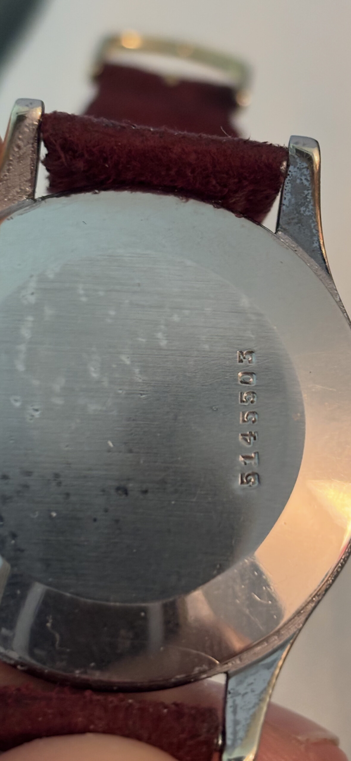

Iemand enig idee van welk jaar deze is?
SERIAL NUMBER SYSTEM 1940-1966
In 1940, Doxa introduced a 7-digit serial number system, with the first two digits corresponding to the year of manufacture. In other words, 40XXXXX corresponds to 1940, and so on.
The serial is always stamped on the outer side of the case back.
Movements had a Doxa stamp on them, but no serial.
PRE-1940: The archives were destroyed by a flood in 1966- if the Doxa you’re trying to identify does not follow that pattern, three things can be the reason behind that:
  1. In the 1950s, there was apparently an additional numbering system- although I’m not even close to being familiar with that. If anyone is- please post any info here, in order to make this short guide more detailed.
  2. Pre-1940- if the serial does not follow the 7-digit pattern, and the watch is equipped with an Aurore-Villeret 110 movement (wristwatches) or an FHF with modified bridges (pocket watches), just the decade of manufacture will do… If you have a presentation Doxa watch with a date on it- good for you. Otherwise… Well, sorry. Dating to the nearest decade is as good as it gets. For a wristwatch with an A-V 110, most likely 1930s.
  3. Frankenwatch- if the case does not have a correct Doxa stamp inside- walk away. Even if there’s a 7-digit serial on the case back. If the first two digits make no sense (like 41 on a watch with an ETA 1080 and 1950s looks to it)- yeah, you can be pretty sure it’s a generic case. For dirt-common movements it’s no challenge to find a generic case.
    NOTE: The serial number system 1940-1965 not necessarily applies to gold cases, which often use a different code- unfortunately, the lack of documentation makes it unresearchable, and therefore useless in dating a watch.
Dankjewel Geert.
Dat moet dan 1951 zijn.
