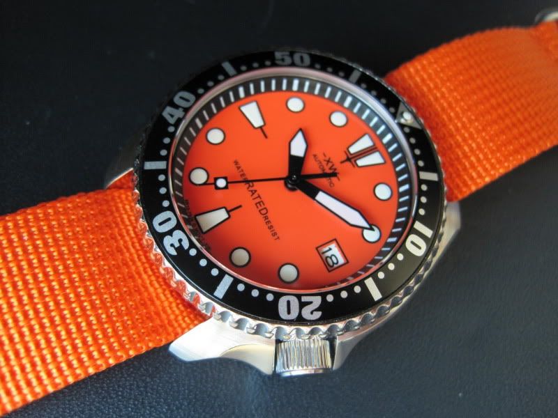

(and the remnants became this, simple swap and blast)
