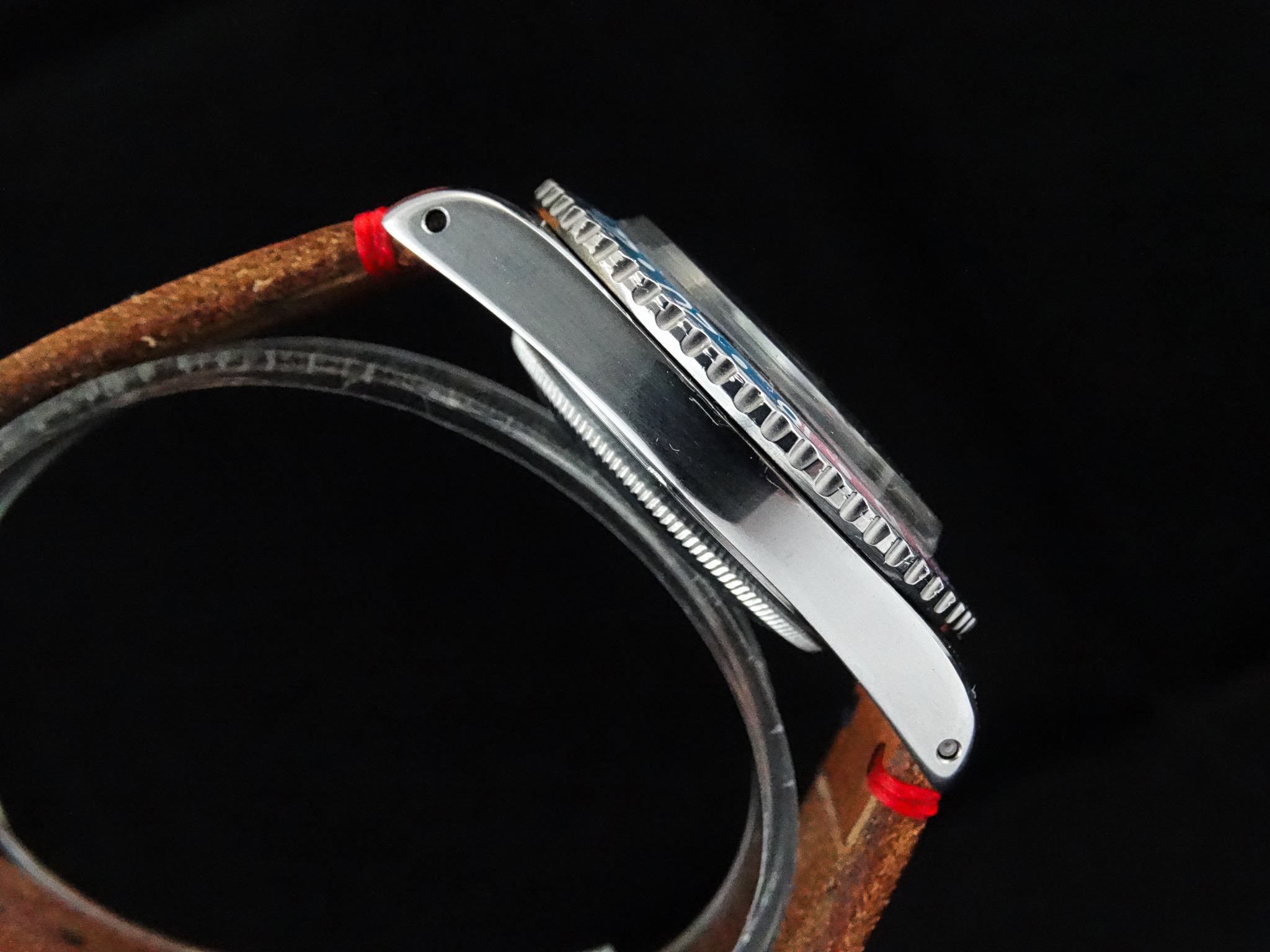

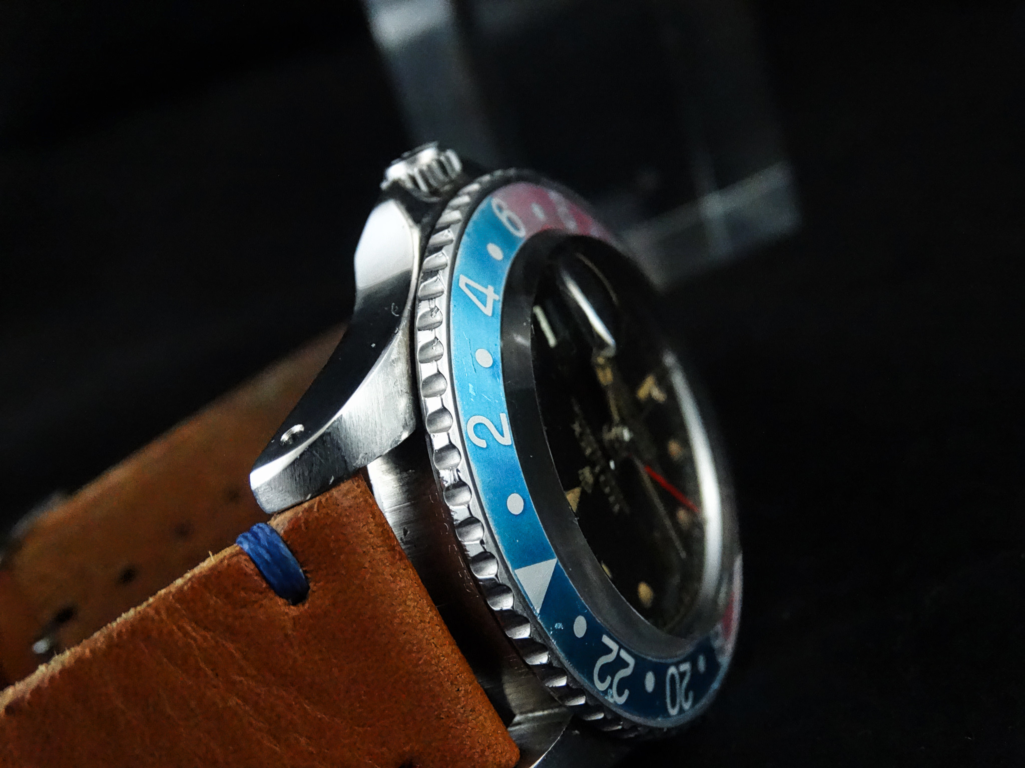

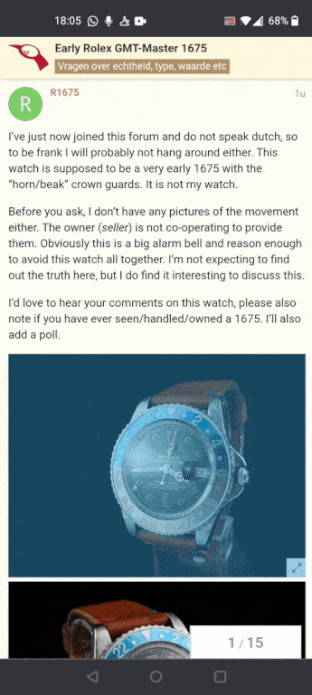

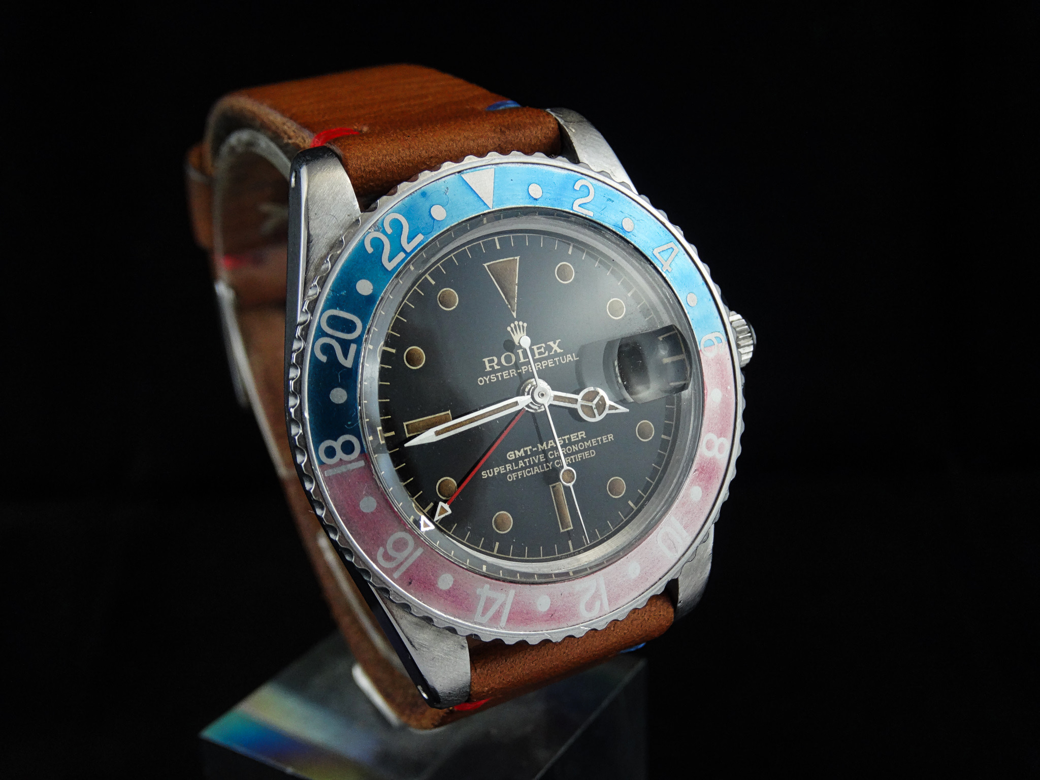

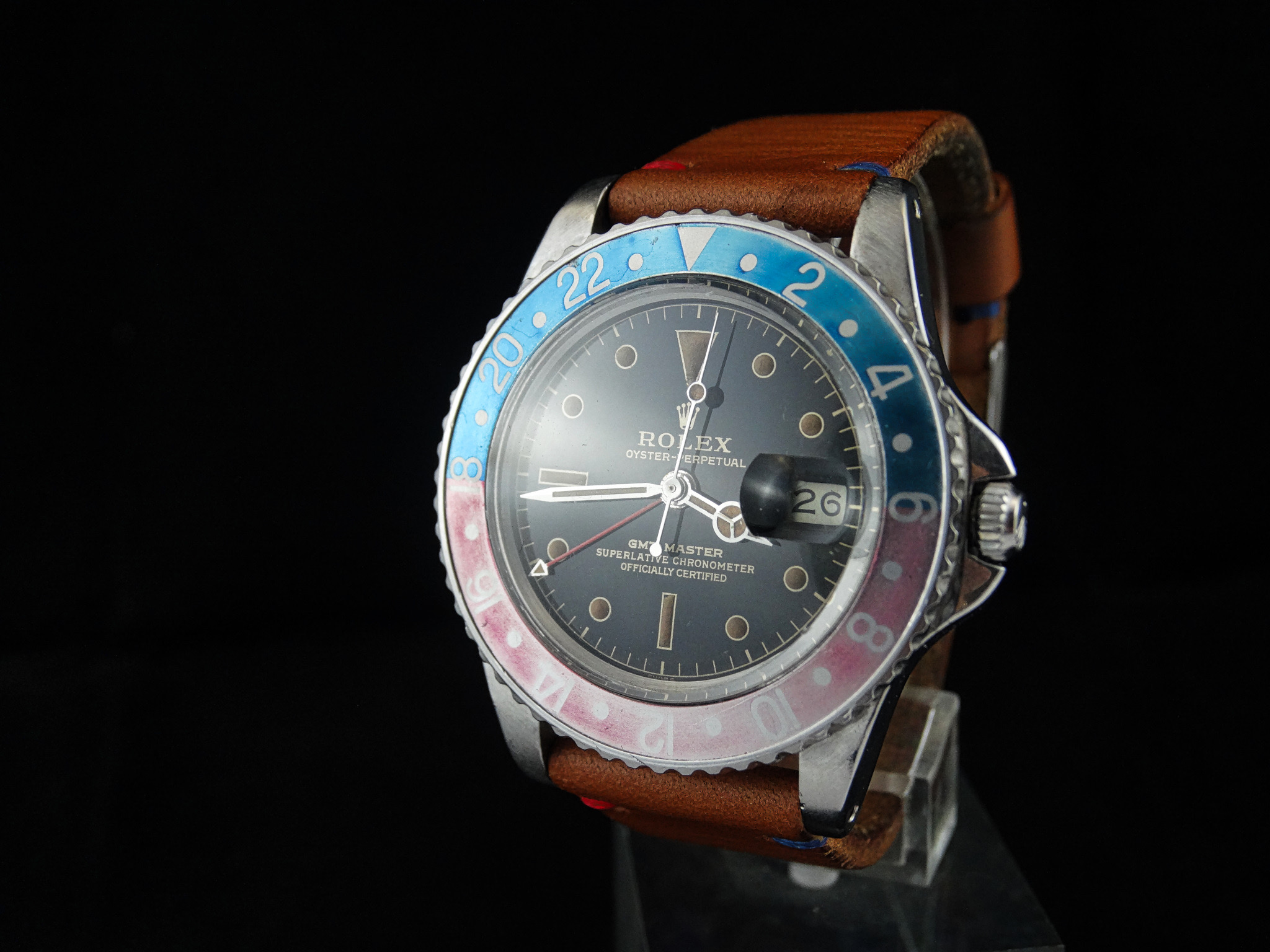

I’ve just now joined this forum and do not speak dutch, so to be frank I will probably not hang around either. This watch is supposed to be a very early 1675 with the “horn/beak” crown guards. It is not my watch.
Before you ask, I don’t have any pictures of the movement either. The owner (seller) is not co-operating to provide them. Obviously this is a big alarm bell and reason enough to avoid this watch all together. I’m not expecting to find out the truth here, but I do find it interesting to discuss this.
I’d love to hear your comments on this watch, please also note if you have ever seen/handled/owned a 1675. I’ll also add a poll.

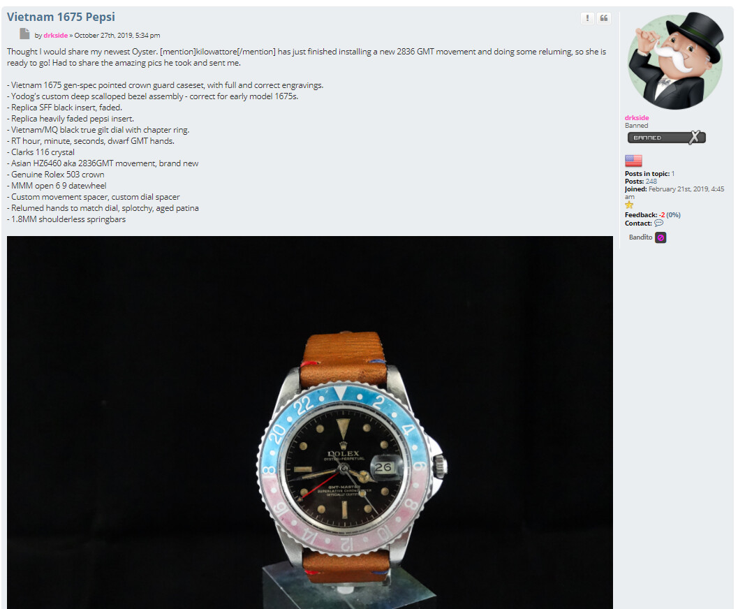

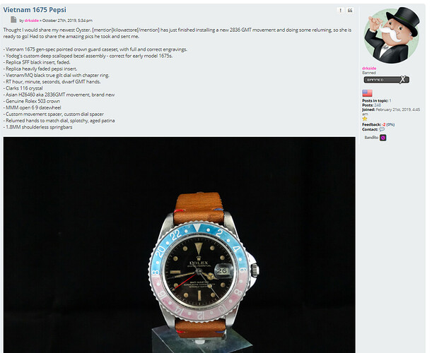

Check this out.
You need to create an account first, but takes just a minute.
http://homage-forum.com/viewtopic.php?t=2766&sid=d95d4aac2e8c98b2b22412a74b35a986
Sounds like someone made a real project of this one, does not sound appealing at all for me personally…
As Bono would say,
Dat is hetzelfde horloge. Hartstikke fake dus.
Thank you!
I’ve tried reverse-image searching some of the images, but could not find anything. May I ask, how you did?
I was convinced it was a “frankenwatch” with at least not the original movement and most likely some other aftermarket/fake parts. But I was sure that the case was at least original, I’ve never seen a (decent) fake early 1675 case.
Turns out, only the crown is real :joy: ! They did do a good job on this one…
