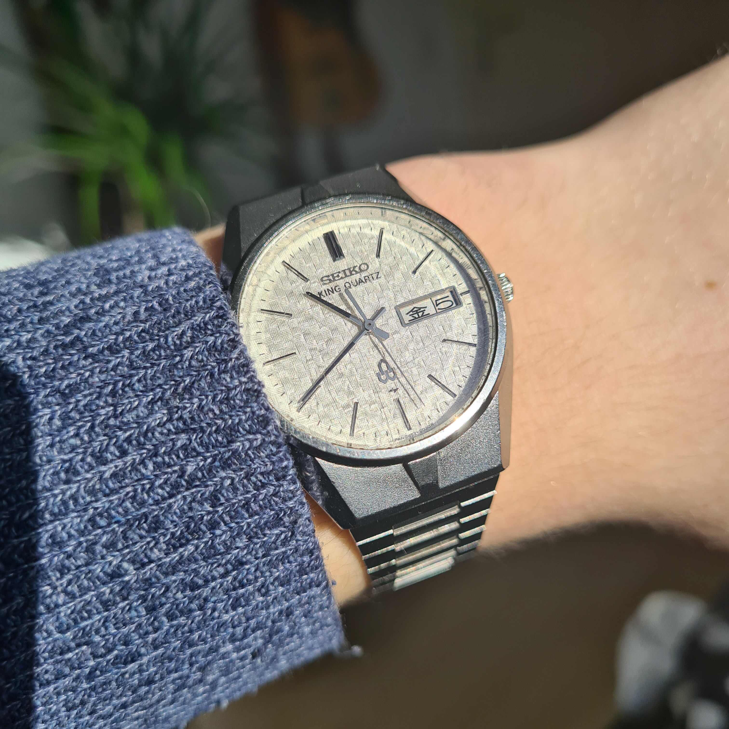

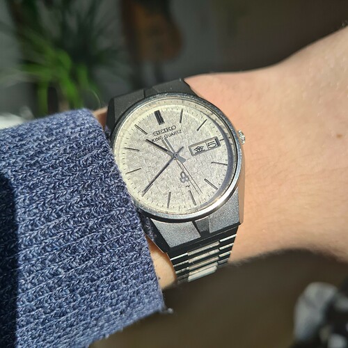

Seiko King Quartz

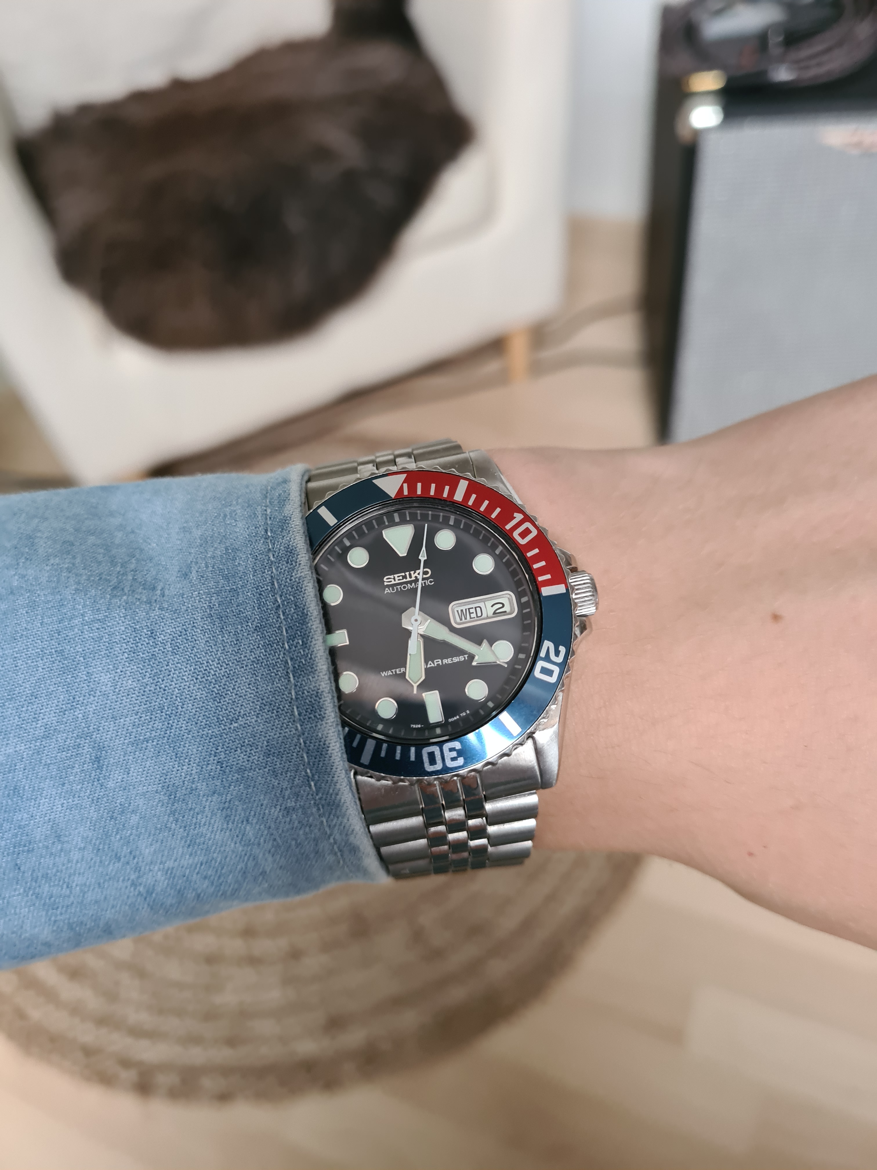

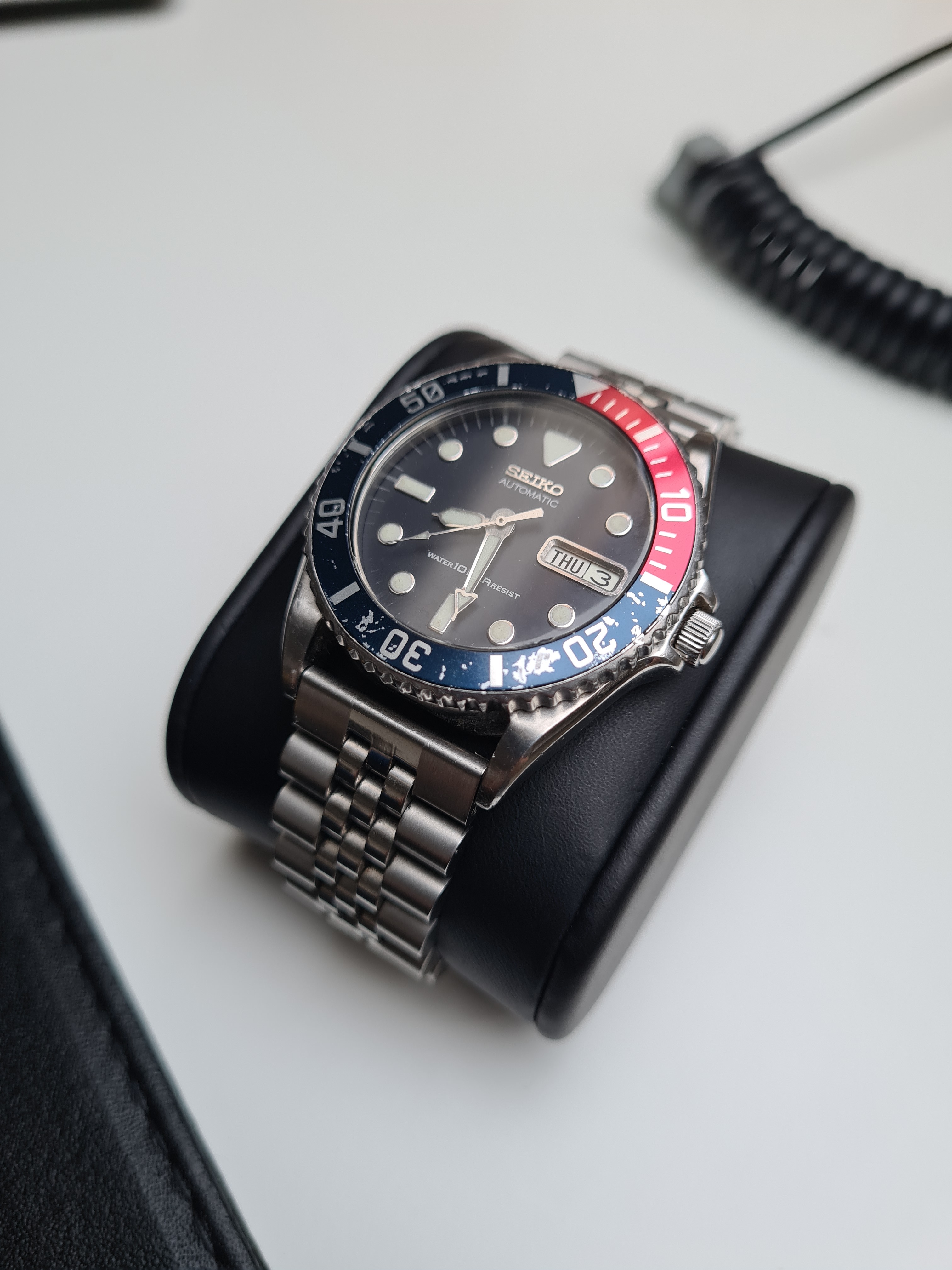

Seiko SKX033
Seiko SKX023
