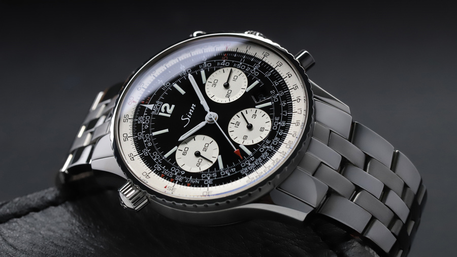

Kan iemand mij iets vertellen over het La Joux Perret 8000 caliber dat tegenwoordig in de Sinn 903 zit. Hoe verhoudt deze zich tot de Valjoux 7750 of het Selita equivalent ervan.
Ik weet alleen dat de wobble van de 7750 een stuk beter hoorbaar is.
De Perret is stiller waardoor ik hem liever heb dan de 7750.
Wat betreft verdere specs kan ik je niks vertellen.

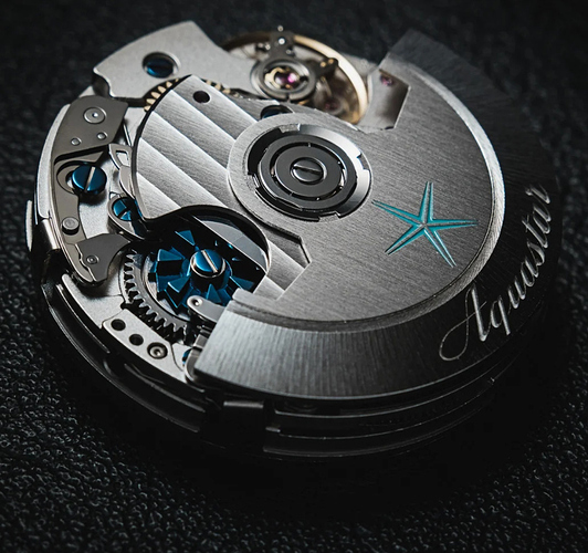

Na lang zoeken vond ik dit stukje over de LJP in mijn Aquastar.
For decades the Swiss high-end movement maker La Joux-Perret stood in the shadow of the brands they manufacture customized movements for, you would be surprised to know how many high-end watches are powered by a LJP caliber that they call their own MANUFACTURE movement.
The Caliber that powers the 2020 Deepstar is based on the LJP 7773, adapted to the functions of the 2020 Deepstar. While the 7773 is physically compatible to the ETA 7753, which means that a watch case, hands, pushers and dials designed for an ETA 7753, can also be used for a LJP 7773, otherwise they don’t have much in common.
The LJP 7773 is a refined caliber, extremely well finished and doesn’t have any plastic parts, equipped with a column wheel that makes the operation of the pushers crispy and smooth, while it is a gem, it doesn’t come with the alures, its service intervals are like any other ETA caliber and the service costs are as low as a common ETA caliber.
I like to emphasize that there is no lack of transparency intended and there is no mystery here of any kind. The brand relaunch and the 2020 Deepstar release were the major talking point in the community and that’s maybe why the movement topic received less attention. Aquastar is proud to be a partner of LJP and you are welcome to ask any questions. I attached a picture of the base movement.

Mooi is dat. Sinn is echt alternatieve uurwerken aan het gebuiken. Ik keek naar een 144 blijkt er een Concepto C99001 uurwerk in te zitten. Weer iets onbekends.
Een discussie op het sinn forum.
https://www.sinn-uhrenforum.de/index.php?page=Thread&threadID=13653
