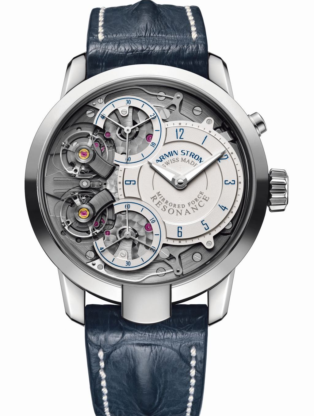

Van de Nieuwe Armin Strom Mirrored Force Resonance zie je nu hier de voorkant :slight_smile:
The advantages of resonance are threefold:
A stabilizing effect on timekeeping (advantageous to accuracy).
  1. A conservation of energy (think of a professional cyclist riding in the shadow of another cyclist in a racing situation).
  2. A reduction of negative effects on timekeeping accuracy due to outside perturbation such as shock to the balance staff, which in turn keeps the rate more stable and increases precision.
  3. An outside shock that slows one of the balances down increases the speed of the other one by the same amount; both balances will strive to get back in resonance, thereby averaging and minimizing the effects of the outside influence as they find their rhythm.
Dit kaliber heeft 2 uur nodig om ‘in sync’ te komen :slight_smile:
Staal, 43,4 mm., 48 uur gangreserve, CHF 54.000,00
