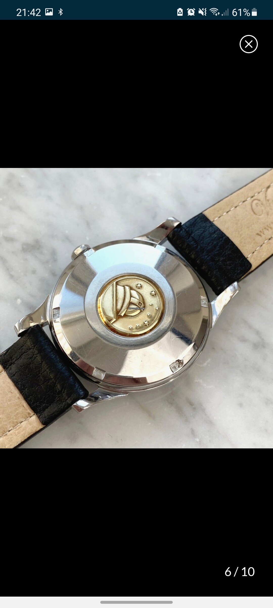

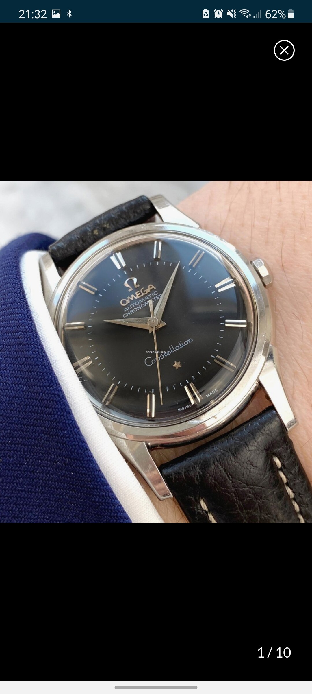

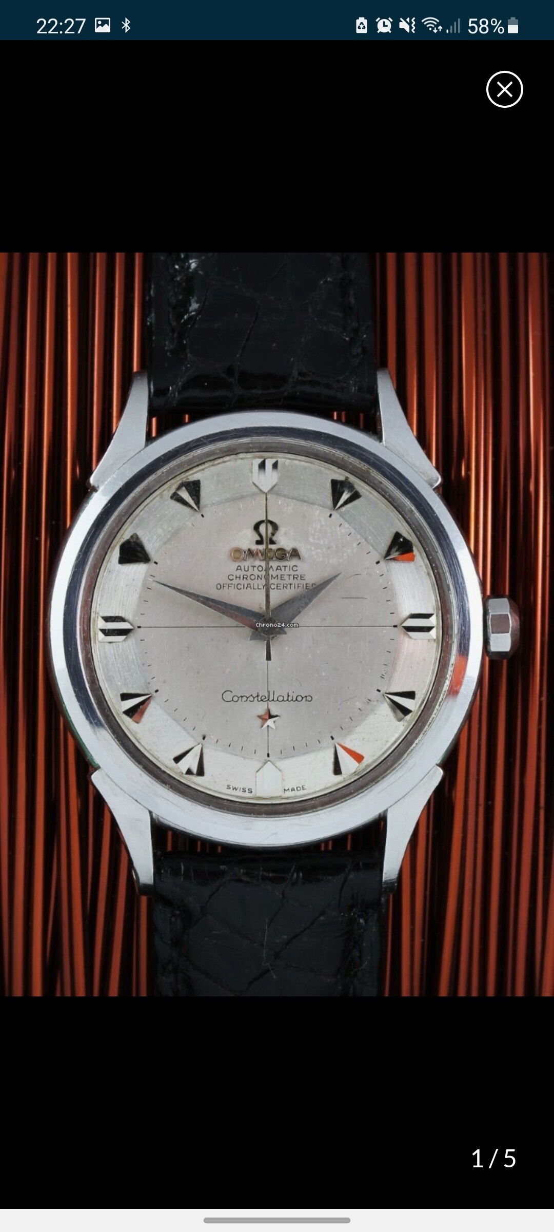

I have the chance to buy this watch. The negatives are that the glass is replaced and the dile has been repainted. The watch is not serviced as well.
Do you see any other parts that are not authentic?
Also what do you think this is worth?
Well, the text Omega looks really weird. That would really annoy me.
I have no interest in redials/refinished dials myself.
Don’t. Because of the repainted dial.
Black, glossy dial vintage Omega - all warning signs flashing.

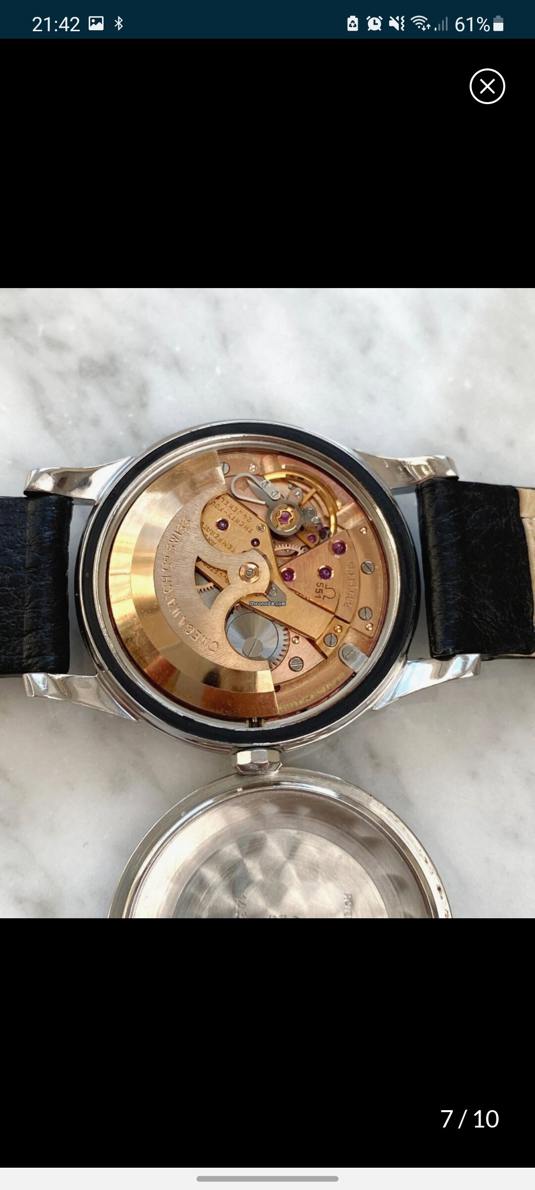

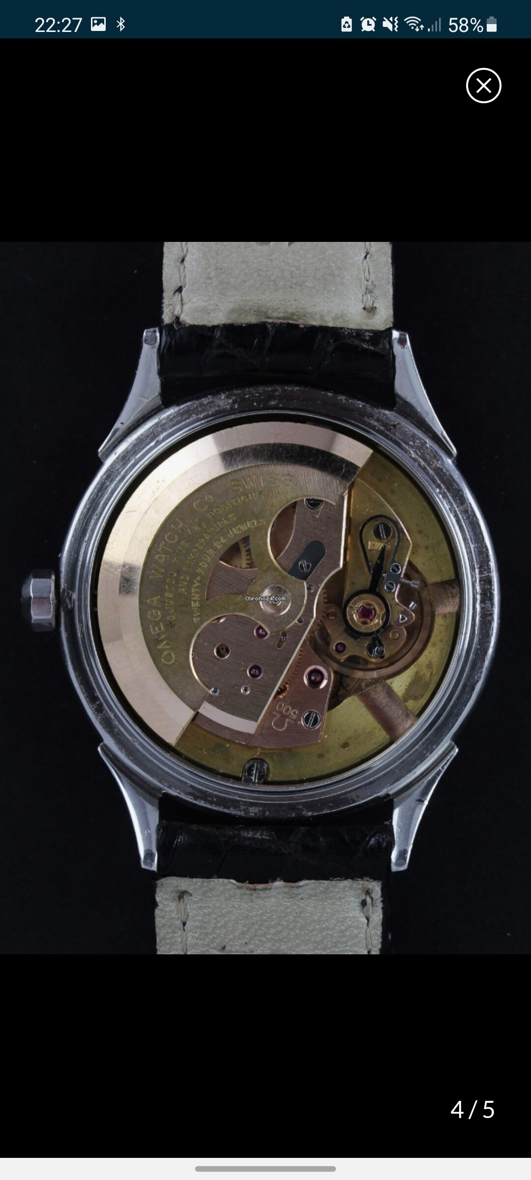

Rotor/oscillating weight-bearing is shot, too; because there are clear wear-marks on the base plate underneath. Yep, I did enlarge the picture. And worked on many of these.
Wow did not expect these comments. Thanks!
Worth 200€ tops. Parts value.
Zou ik ook laten liggen. Wijzerplaat is niet goed en het uurwerk ziet er ook raar uit. Elke brug heeft een andere kleur.
