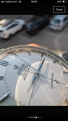

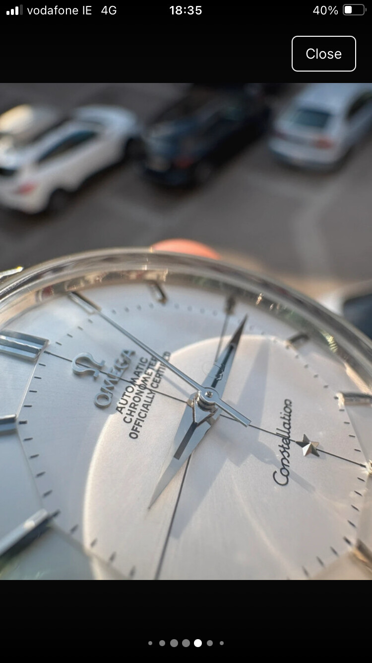

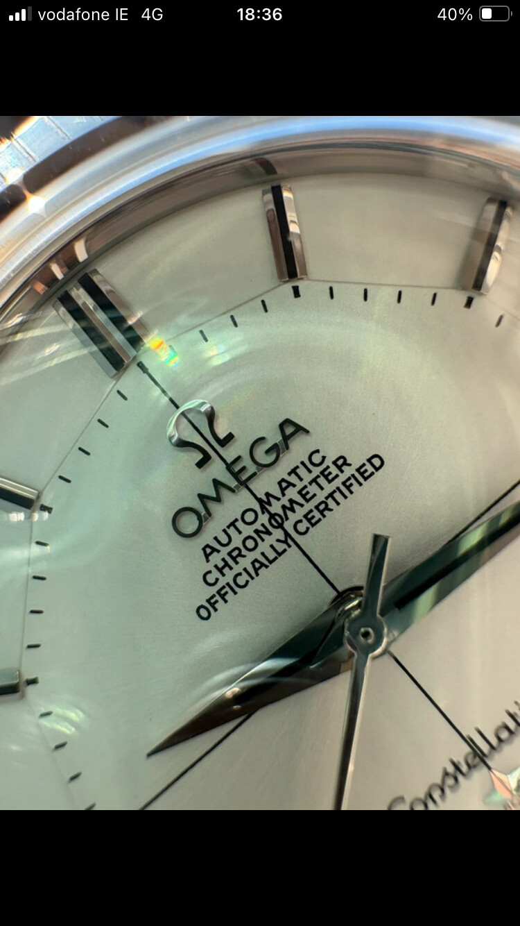

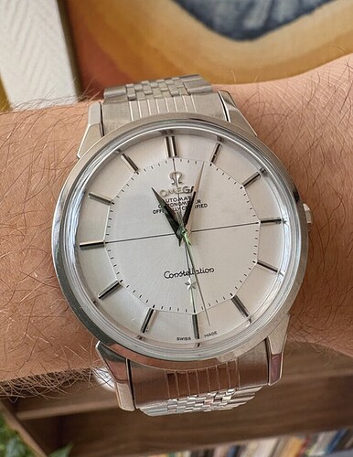

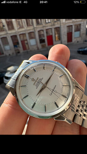

I was wondering if I could get the help of the experts on this dial?
Does it look legitimate. It seems maybe too new?
Any help much appreciated, thanks
Unfortunately that is a redial. The overall print is far too thick.
Ah ok thank you. I thought it was too pristine. They’re looking for 800 euro, so maybe worth it if the rest of the watch is original?

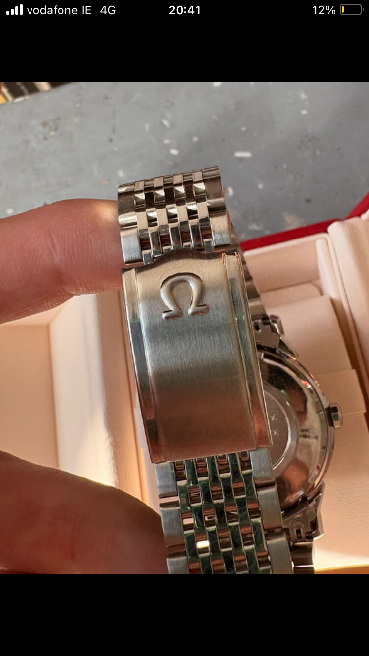

Although I would guess the bracelet is also probably not original.
Thank you for your response
I think 800 is fair-ish for a redial. With a legitimate dial it would be about double or more, depending on condition.
Personally I would always go for an all-original one.
Thanks for the help!

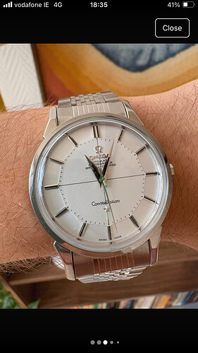

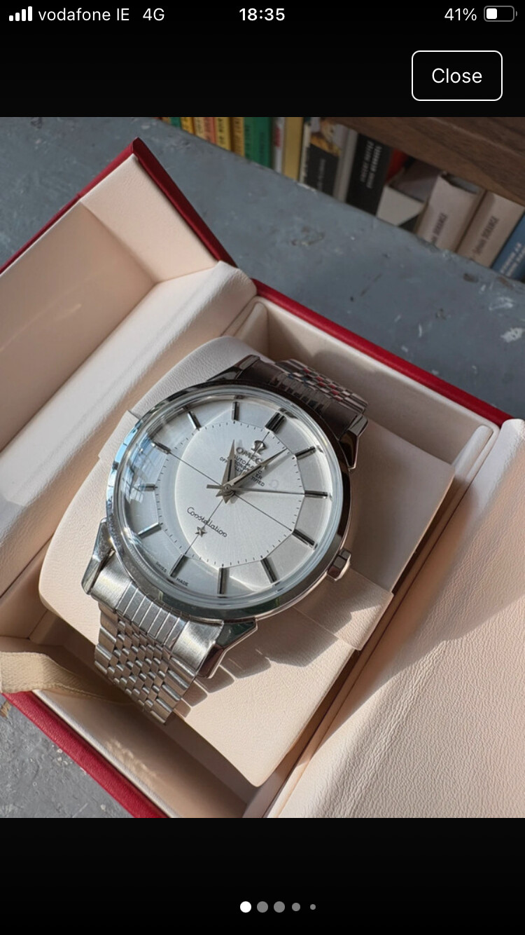

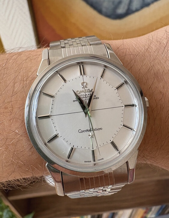

In your opinion does the rest of the watch look legitimate?

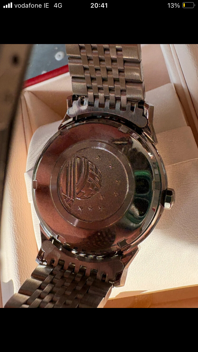

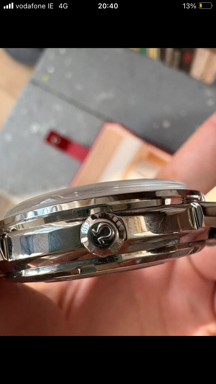

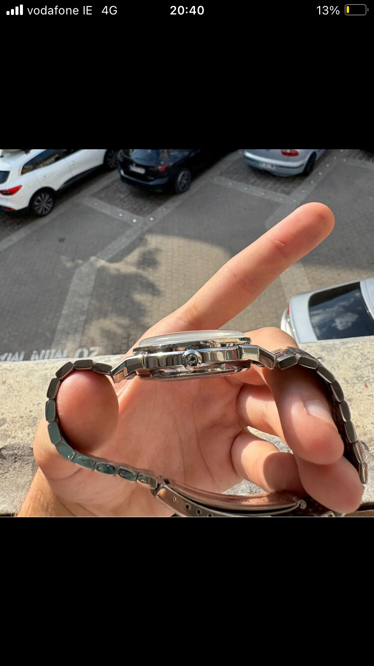

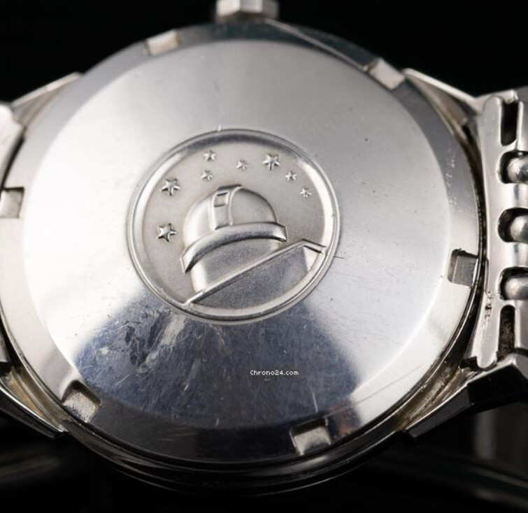

No, not really. The case itself looks very thick from the side. The engraving on the caseback is not how it should be on a 167.005.
After a better look, this doesn’t look like 34,5mm to me, even on the smallest wrist. Stay away from this one. Who is selling this?
AliExpress…
https://www.reddit.com/r/ChinaTime/comments/w0mea2/50_omega_constellation_pie_pan_kit/
Take a look inside. And you’ll probably find a Miyota.
These cases are known to have fake reproductions. One give away is the side profile @flowert mentioned.
If i find the time, ill look for the fake case guide. Its on omega forum somewhere.
Combining the redial and the wierd case dimensions, i would skip this watch completely.

The bracelet is fake.
