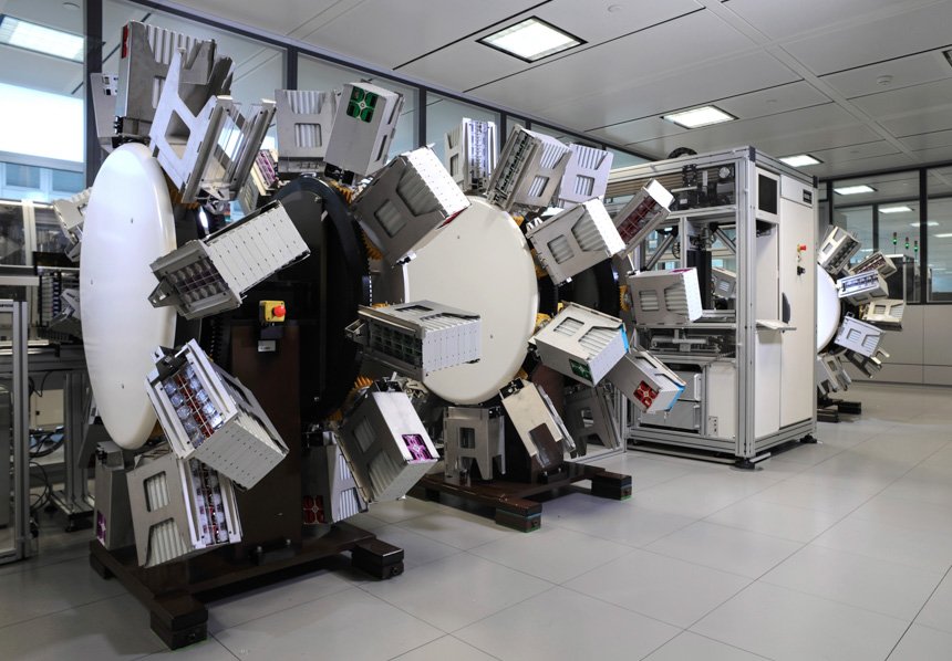

Als een Rolex de fabriek verlaat is deze al ingelopen door alle langdurige tests die deze ondergaat.
It would be an understatement to suggest that Rolex is obsessive about quality control. A predominant theme in the manufacture is that things are checked, re-checked, and then checked again. It feels as though their goal is to ensure that if a Rolex watch fails, it does so before it leaves the factory. Large teams of watchmakers and assembly people work on every single movement that Rolex produces. This is before and after their movements are sent to COSC for chronometer certification. And on top of that, Rolex re-tests their movements for accuracy after they are cased for several days while simulating wear before they are sent out to retailers.
