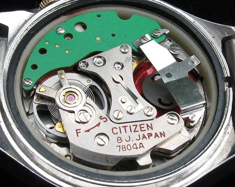

Beide in 1 horloge!
Bv: citizen cosmotron
