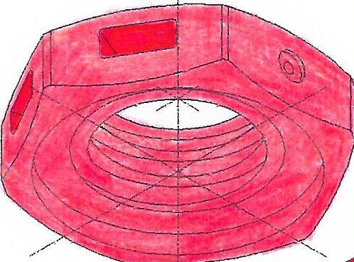

I would like to show you our automatic timepiece with Swiss mouvement and unique shape, derived from an industrial nut.

Well, the peculiarity of this project lies in the watch body realization: we are a couple of friends working in the steel industry, we have started from a nut and its screw to imagine a double case timepiece.
From the screw we obtain the inner case, which holds the ETA 2671 mouvement:
And the machined nut (M24 or M27) become the outer case, on which the 4 lugs are anchored.
All work is done here in northern Italy, Milan Far East, all handcrafted on lathe and on 5 axis machines.
The complete story can be founded at rdbwatches.net

The side engraving is to identify the case. There is no back case here, the watch is mounted starting from the bezel.

This ETA was a forced choice due to the minimum space available (the screw head is machined to hold the mouvement in place).
Also we do a couple of in house modify on it, basically the date display removal and the bague elongation to match the case.

The watch body is composed of 8 pieces:
Bezel
Outer case (nut)
Inner case (screw)
Lower ring
4 lugs
All the pieces are machined on lathe or on 5 axis machine tool (the lugs).
No cast metal pieces here.
