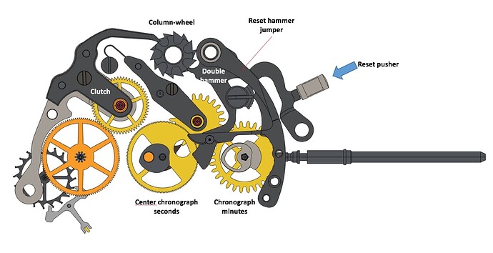

even terugkomend op de mooie verschillen tussen de chronografen techniek.
We zijn het erover eens dat een column wheel iets bijzonders is.
een CW met verticale koppeling en horizontale koppeling is wel nog een verschil.
De JLC heeft dus een CW met verticale koppeling. Even de voordelen van een verticale koppeling:
As its name indicates, with a vertical clutch, the chronograph mechanism’s coupling is positioned vertically, similar to the systems found in cars that connect the engine flywheel with the transmission. While horizontal clutches are visible, simpler and thinner mechanisms, the theoretical advantage of a vertical clutch is that there are no sharp teeth to engage or disengage — a mechanism that can lead to the notorious and ugly jump of the chronograph seconds hand, not to mention excessive wear and tear.
In a vertical-clutch system, the chronograph wheel and the drive wheel are located concentrically, sharing the same axis. The latter, in fact, is constantly running for as long as the watch is working. The vertical coupling clutch employs a pair of levers or arms that keep the chronograph wheel “floating” above the ever-rotating calibre drive wheel. When released, both arms allow the clutch to fall on the seconds wheel, which then starts to rotate, thanks to the friction between them. As an example, think of a vinyl record that is dropped onto a turntable. Inside the watch, when the clutch drops, both wheels begin to turn simultaneously. This offers significant advantages: precise starting and stopping of the seconds hand and the ability to use the chronograph function for long periods without affecting the watch’s accuracy due to minimal wear. Also, there is no loss in the balance wheel’s amplitude. Pressing the stop button causes the clutch arms to be inserted below the clutch to lift it, instantly disconnecting the chronograph wheel from the drive wheel and stopping the running of the chronograph seconds hand.

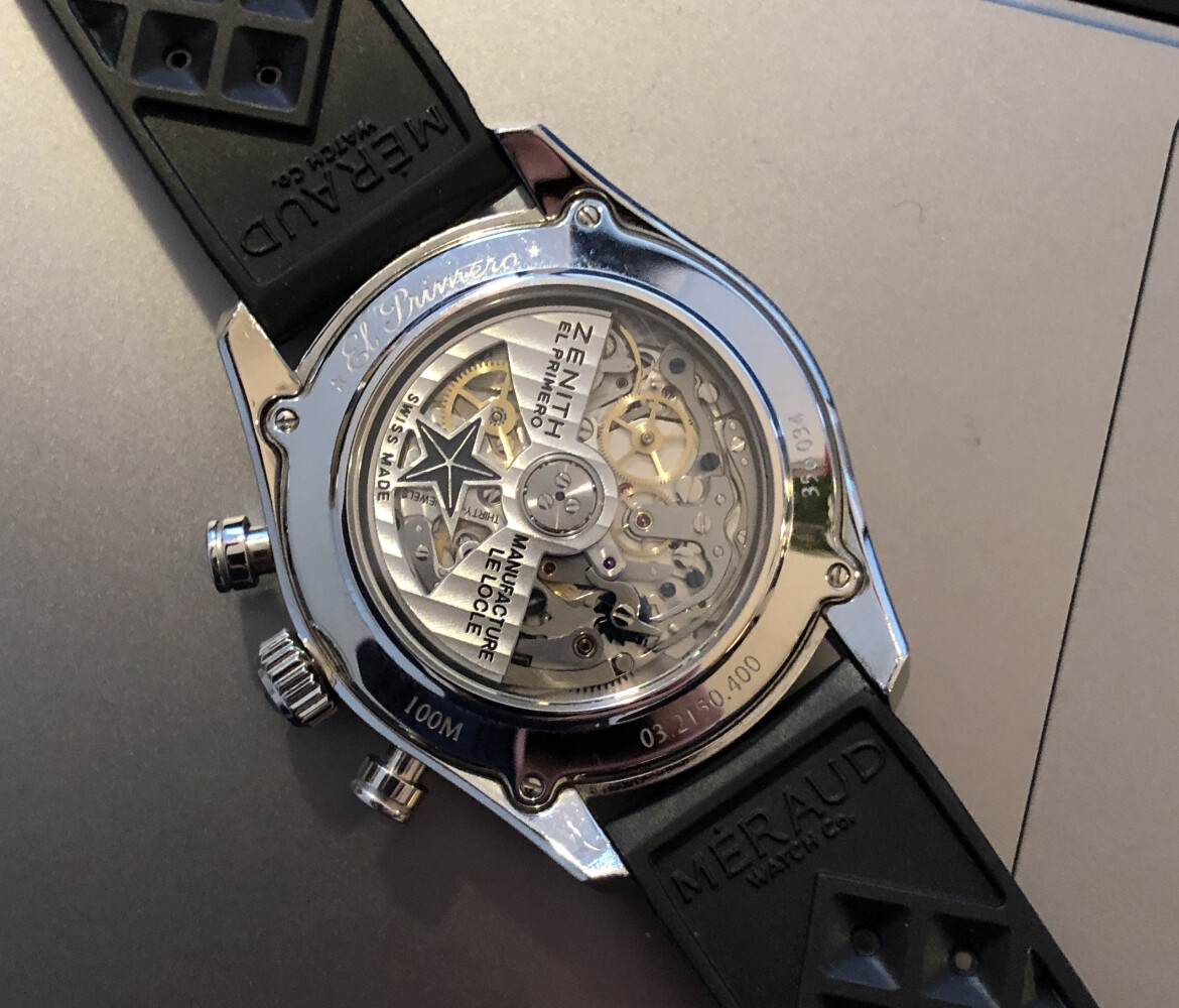

Dat is niet geheel correct. De jlc is verticaal, de seiko ook, maar de el primero is een horizontale koppeling. :grin:.
Uit praktijkervaring kan ik je zeggen dat die soepel zijn, maar de jlc is veul soepeler. Horizontal vs verticaal is dus gepareerd.

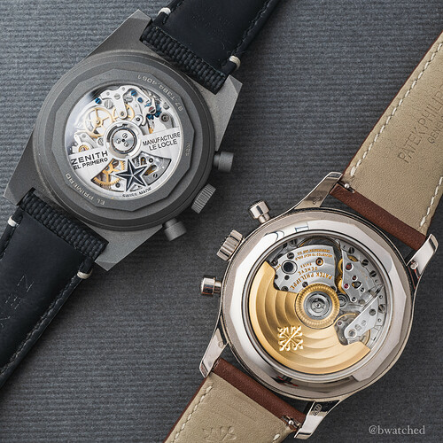

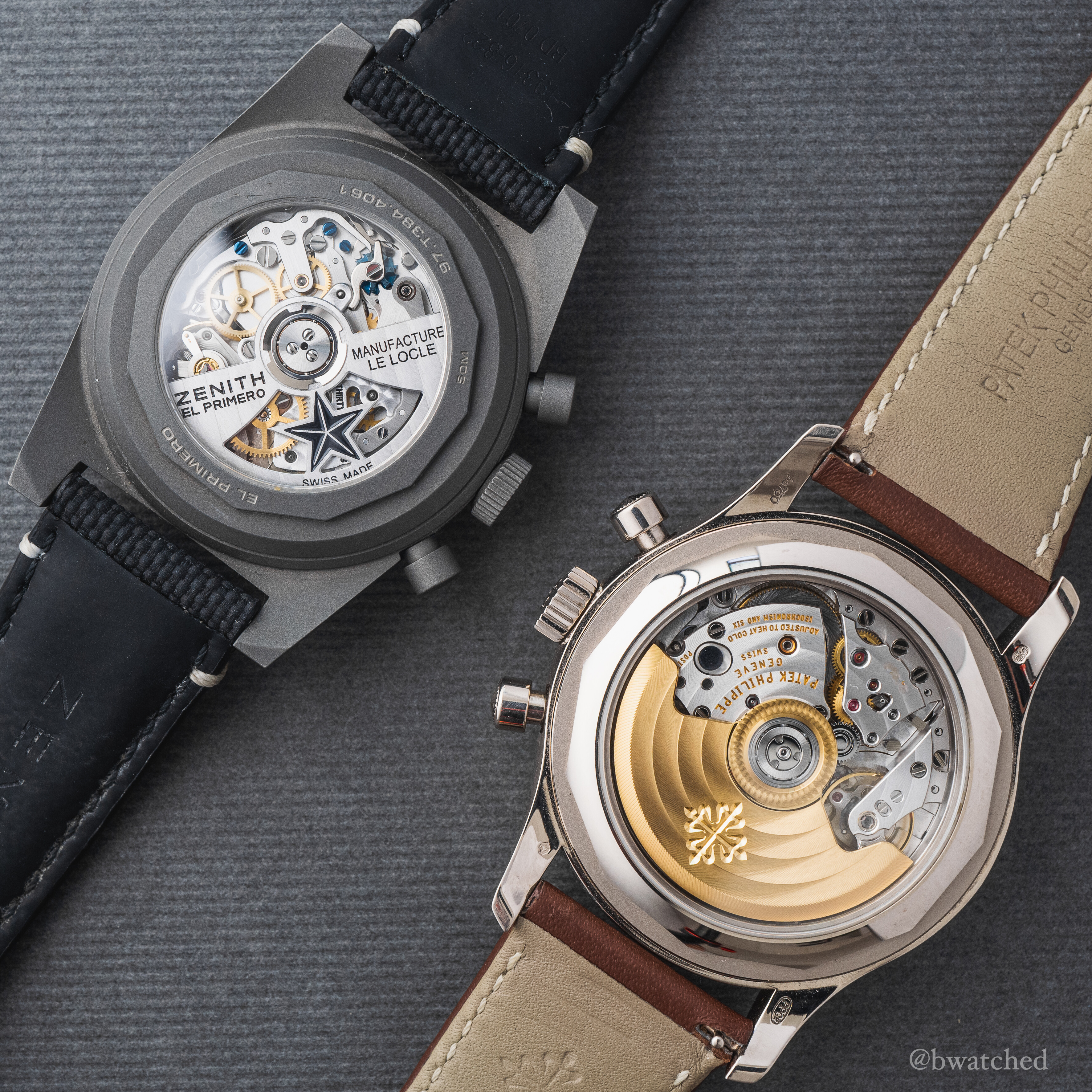

Hier een leuk vergelijk tussen een horizontale koppeling (Zenith) en een verticale koppeling (Patek)
Hier zie je duidelijk het hele koppelingsmechanisme
Hier zit het meeste onder de bruggen verstopt.

  • Horizontale koppeling (Zenith)
  • Verticale koppeling (Patek)

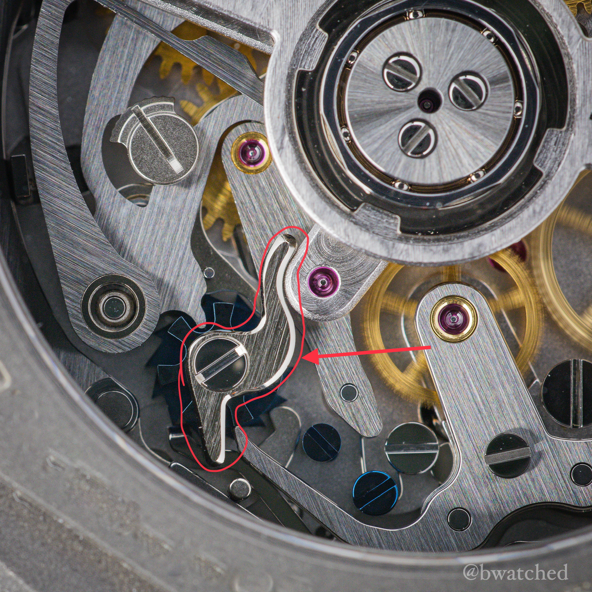

Maar even serieus, ik vraag me al een tijdje af wat dit voor een ding is dat bovenop de CW is geschroefd.
Het is een van de weinige onderdelen met mooi afgewerkte randen (anglage).
Bij zenith zal het vast een belangrijk onderdeel vinden. Ik heb alleen geen idee wat het is :man_shrugging:t2:

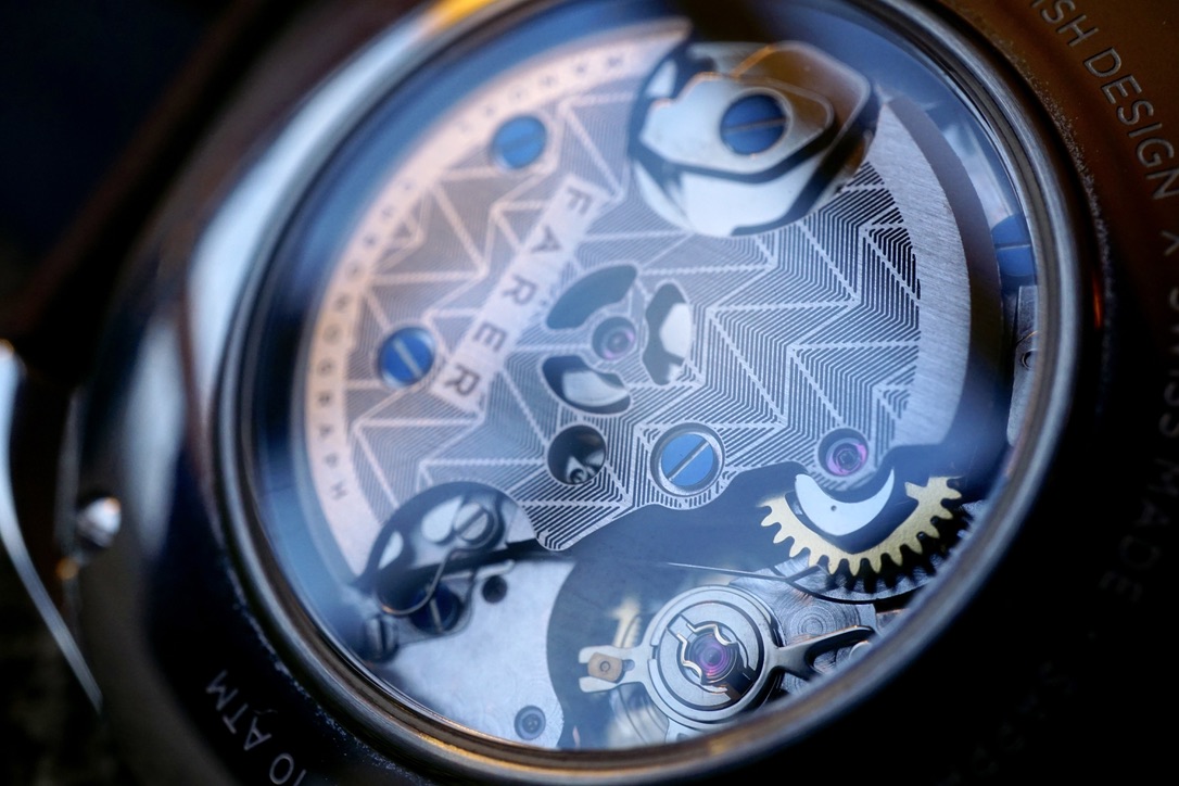

Yup. Zo ben ik nog steeds pissig dat mijn 9F quartz achter een deksel zit. Dat ene cam & lever chronograafje wat ik nog in de verzameling heb heeft ook een horizontale koppeling (en dus allemaal coole bewegende delen), en wat doet Farer?
Brug er overheen.
Zo jammer.
Grappig genoeg was dat ook mijn openingsschot in de goedkope sector… Ik heb nooit verschil gevoeld tussen een Seiko CW VC en m’n Russische Cam & Lever, en die Sellita in de Farer voelt weer beter dan beide voorgaande. Ik denk dat JLC er de toko wel naar is om altijd een smooth uurwerk af te leveren. En dat mag ook wel voor het geld, uiteraard.
Ik zie het ook niet. Met name omdat ik ook niet goed zie waar dat grote zeemonster-achtige ding er naast voor is. Zwenkt die, en heeft dat invloed op het gouden rad er naast?
Dat is de koppeling
Ja, bij het starten/stoppen van de Chrono
Nee dat gouden rat loopt altijd en is gekoppeld aan de small seconds.
Inderdaad wat een gek ding. Vraag mij nu af of de oude tri colore dat ook heeft.
De manufacture heeft dit wel. Net als de shadow.
Edit. De oude heeft dat ook.
Is het zo dat het onderdeel wat we niet begrijpen boven die koppeling ligt? Want als de koppeling op de palletjes van het kolomwiel valt, lijkt het er sterk op dat dat visje er bovenop ligt.

Ik heb het even gevraagd aan een medewerker van zenith.
Kijken of we een antwoord krijgen. :grin:
